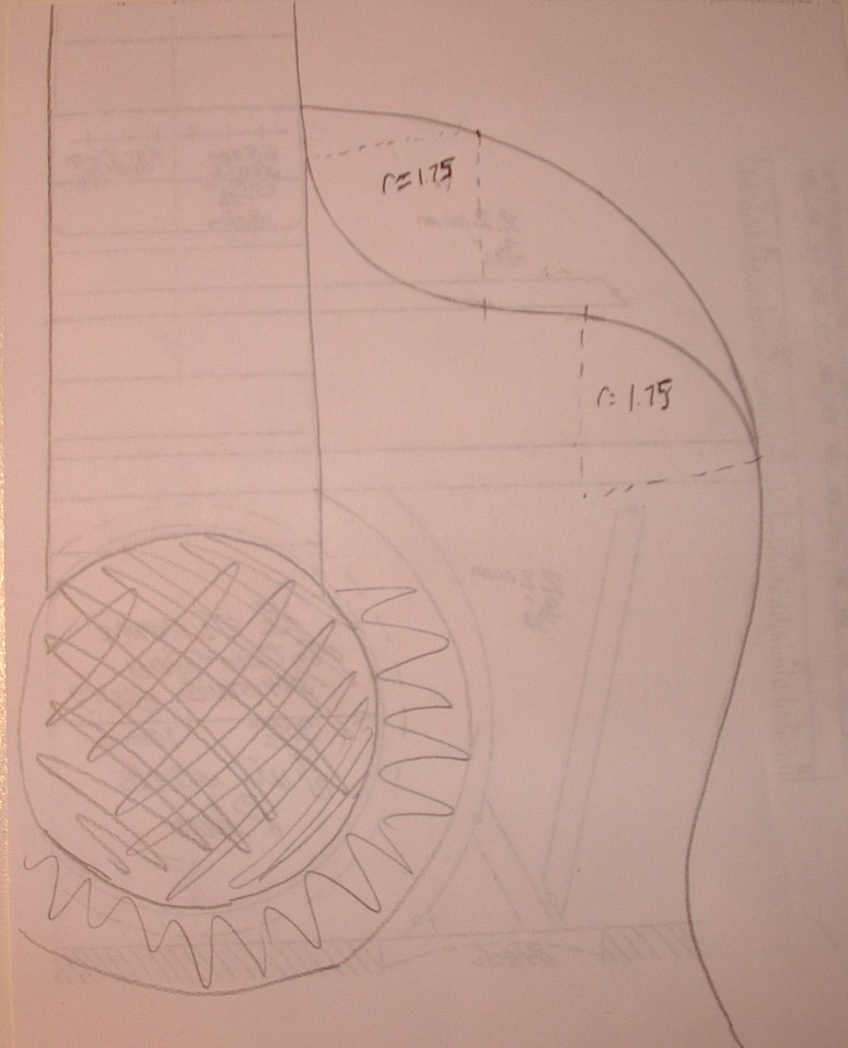

Below are two designs I'm looking at bending. The first is closer to traditional and uses two 1.75" radius bends.

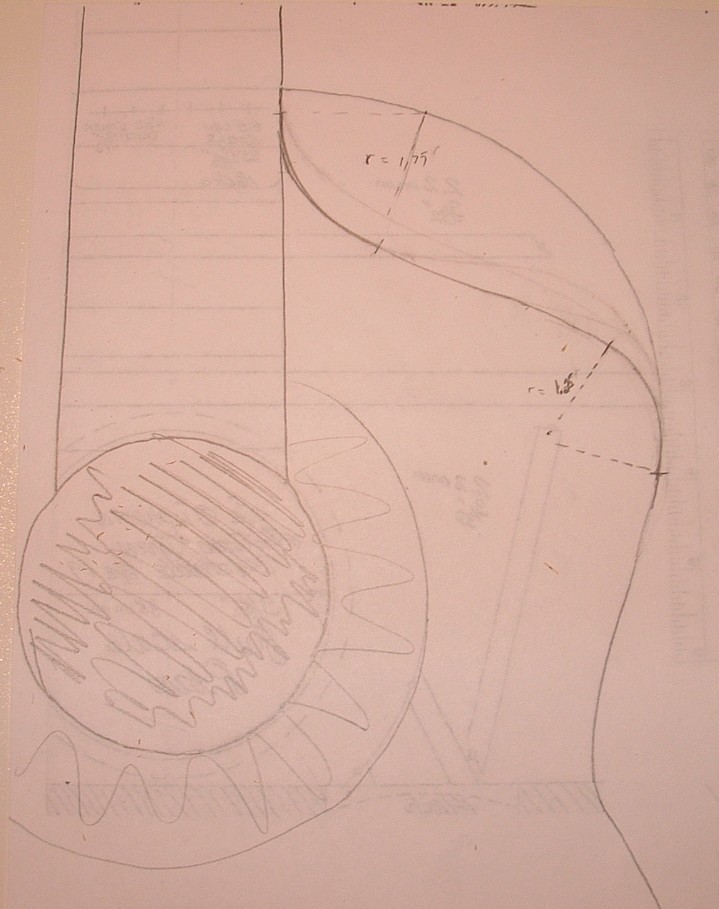

The other is one I'm interested in doing, but does take more of the top
away, and has one 1.75" curve and one 1.25" curve. I'm REALLY nervous
about the 1.25" radius as I'm worried about splintering and cracking
this nice chocolate piece of rosewood.

The upper bout has little affect on the air chambers motion. It will have some on its main resonance frequency. i assume lower the frequency some. Even there I expect very little.
When planning a cutaway the thing I always watch out for is bracing issues and the radius of the bends. I don't like to bend radiuses smaller than 1-1/4" radius to avoid stress fractures (cracks). Also you have well avoided one pit fall of cutaways. That is bends that the included angel of the entry bend is over 90 degrees.
That said I am opposite of you I like deep flowing cutaway bends like this
but they do put more stress on the wood at the apex of the entry bend.
